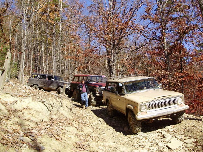

I ran the RC 3" with 0 mods to any lines or cables. Some trails at Tellico and all of them at URE.
The aal and blocks is still a cheap way to get a bit of lift and a decent ride. The extra leaf isn't much...$50 for the kit?
on 32" BFG muds and 8" wheels still a bit of sag, I didn't add the aal to the rear.

Originally Posted by Heimeken
One thing to note here is that we are talking about a 90's Wag. Very different than lifting a 70's cherokee. The Chero is already higher from the factory and the e-brake cables are completely different.
Good point. However, this '78 looked like a low rider when I got it!
