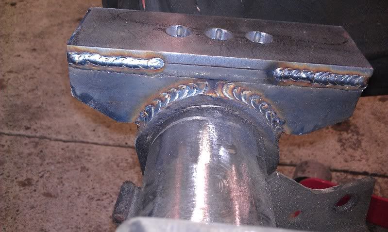

I just got done doing a SOA on my 89. I used a 220v mig using 75/25 Argon/CO2 mix gas. I turned up the heat to penetrate the diff housing and burned in great.
Nice Job!
Yep, just weld it.
Bigger axles are always nice but there are hundreds of those perches out there welded to the diff.

I welded mine with an arc welder and used regular rod on the side with the tube and nickel rod on the side with the pumpkin.
