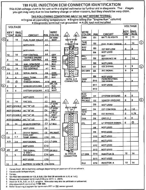

just came back from my business trip and couldn't work on it...today when I was trying to play with it. I found that I have a short somewhere. man, when I lifted of the postive cable from the battery, I got a hughe arc. Not quite sure what happened while it was parked in my driveway...but I guess I have a new problem to chase down.
Anyway, while I was in there, I followed some of your suggestions and made sure there where no vacuum leaks. Just to make sure I don't get any leaks from the charcoal canister and etc, I plugged all vacuum ports besides the one for the heater motor and breaks.
I checked around the base of the TBI as much as i could and did not see anything bad. Maybe I just replace the brand new gaskets with newones to make sure I did not screw up on the initial install.
I guess I will leave the MAP vaccum line on the port rear of the TBI for now, but how can I make sure it acuatlly works like it should?
I followed Bill's link to the Binder Bulletin where he (I think it was bill ) suggested to check the mechanical advance. I have an HEI, how can I make sure that it still functioning correctly?
Bill, I was looking for a thread that explained all the voltage checks you are talking about on the Binderbulletin but couldn't find it (I must be blind) can you help me out here? Also, I ran from parts store to parts store trying to find a scanner for the TBI (OBD1). What is the cheapest option I can get to do some data logging maybe even real time analysis?
You ain't blind. Digging through all that can make you crazy. I knew I'd seen it, too, so I went searchin' through all my bookmarks.
This post says:
"Pull out your meter and sheet 1 of the wiring diagrams....
Look at the 2 outside columns, They are labeled.
"KEY ON" and "ENG RUNNING"
You need to do the key on voltage checks at the plugs on the back of the ECM or where they go to.
This will save a lot of time trouble shooting if the system has problems."

Here is the voltage sheet for a 747 ecm

It's only difficult if you you don't read it closely.
Simply starting at the top of the FAQ's in the FI you will go to the wiring link.
One of the first lines has a link to the diagams LAJ10 just posted.
In the outside column are the key on and eng running test.
Also you don't "need" the aldl cable to get error codes.
If you have the SES light, all you need to do is connect pin A and B together and turn the key on.
The light will blink.
The ALDL cable is also all listed in the FAQs.
