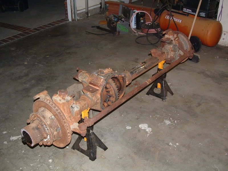

My first major part of the project was the rear axle swap. Here is the thread where I did the 14Bolt swap... http://www.ifsja.org/forums/vb/showthread.php?t=60158
So. Heavy Low is born.

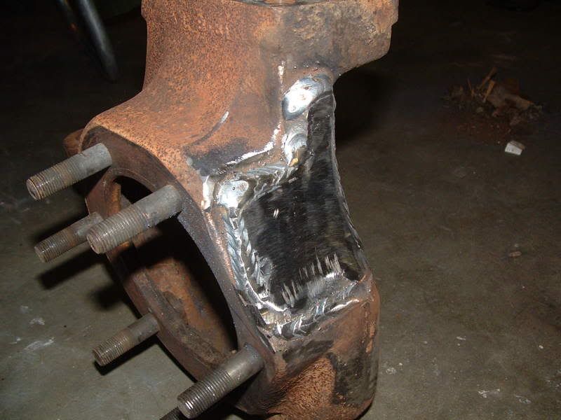

So, back to the build. In summer 2007 I found a Dodge 60. It needed some work.
Upgradessssssssssss \m/ \m/

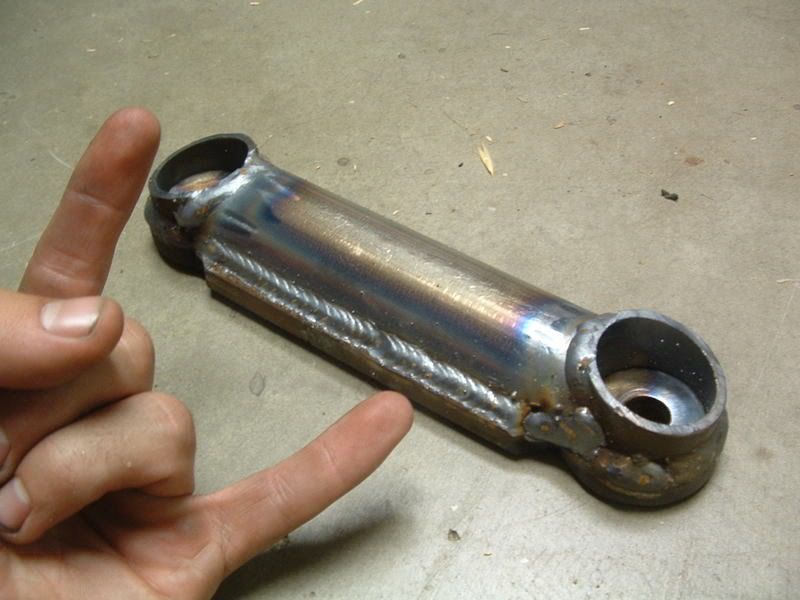

Some shackles i made
Plated knucks

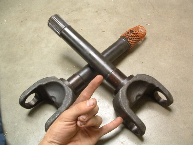

Broached my 30 spline flanges to 35 spline.
FORTIESSS!!

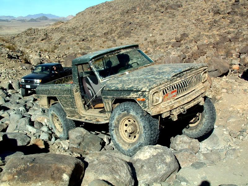

Then there was the first ever trip to the Hammers!!
January 2008

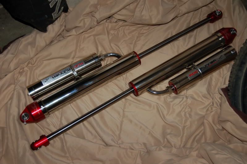

Last summer I got the axles re-geared to 5.13s and mounted some 2.5 x 14 Sway A Way "Rust" Runner shocks.

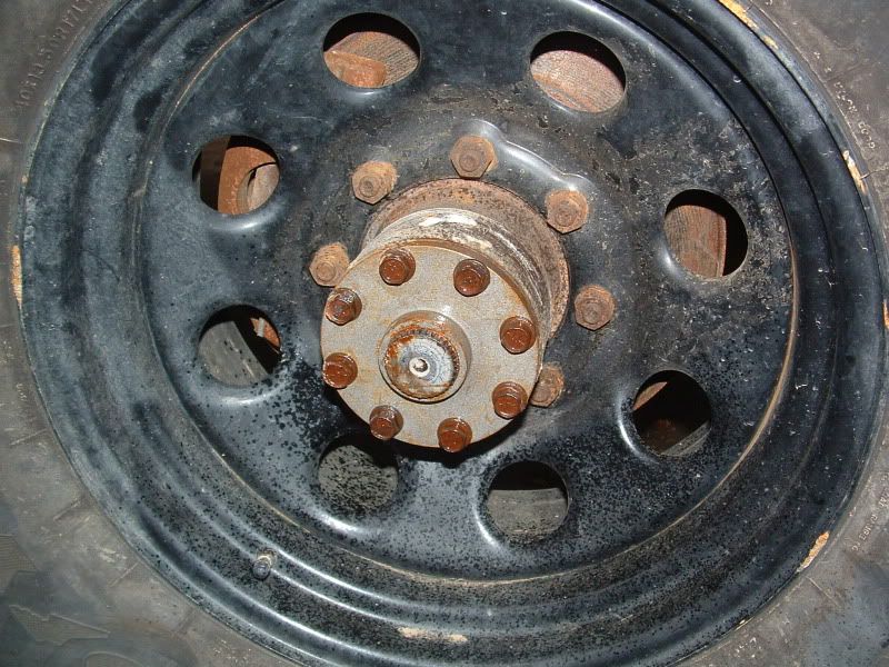

Goodies.
Fred Williams old 39s
Some Rust A Ways for the rear. 2.5"x14" Piggy Smooth Bodies. I did an initial re-valve on them. Heavier rebound. It's a valve stack of .010s on both compression and rebound. We'll see how they end up working in a couple weeks.
