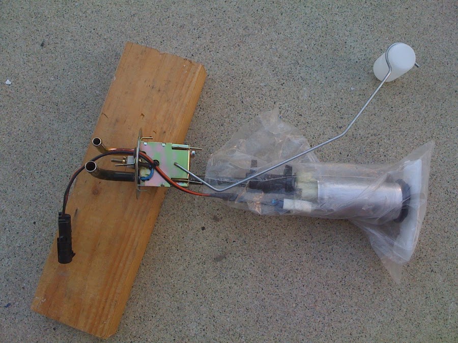

Old 05-19-2018, 12:03 AM
babywag babywag is online now
Posts: 9,809
The one living in my ‘88 looks like this...

Oh ok. So you just adapt a submerged pump to the stock sender. That's pretty slick. So I just need to find a GM vehicle with a similar style pump that uses ~58 psi for the injection system. TBI uses lower PSI, right?
Old 05-20-2018, 06:30 PM
Posts: 9,809
regulators set pressure, not the pumps.
something from a later model car/truck w/ v8, and should not be terribly difficult to find & use.
The LT1 pump is compact, it’s 5/16” outlet.
It’s stepped up to 3/8” by larger pickup tube.
Can be had for $16-$70 depending on brand.
Used in ton diff. GM cars & trucks.
Just one example, several others.

I ended up cutting off the pick up and return tubes on a stock replacement sending unit, drilled out the holes and soldered 3/8 tubing bent 90 deg. to it.

Yep, I did the same (modified stock sender to hang an EFI pump on it) and no complaints. I let the 5/16 tube stay in place (the old carb's feed line) as a return, unsoldered the 1/4" return, drilled the hole to 3/8 and bent some tubing.
Every V8 with EFI that I'm aware of came with 3/8 feed and 5/16 return. I don't need any other reason to do it that way, too.
When in doubt, imitate the OEMs as best you can.
