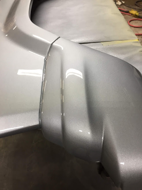

Painted the hood today and used the wrong reducer and it is not going to make it. Also shot one fender today and it came out really good.

Body work on fender was spot on and the paint came out nice. I did this after I screwed up the hood.

Hardly any orange peel!
