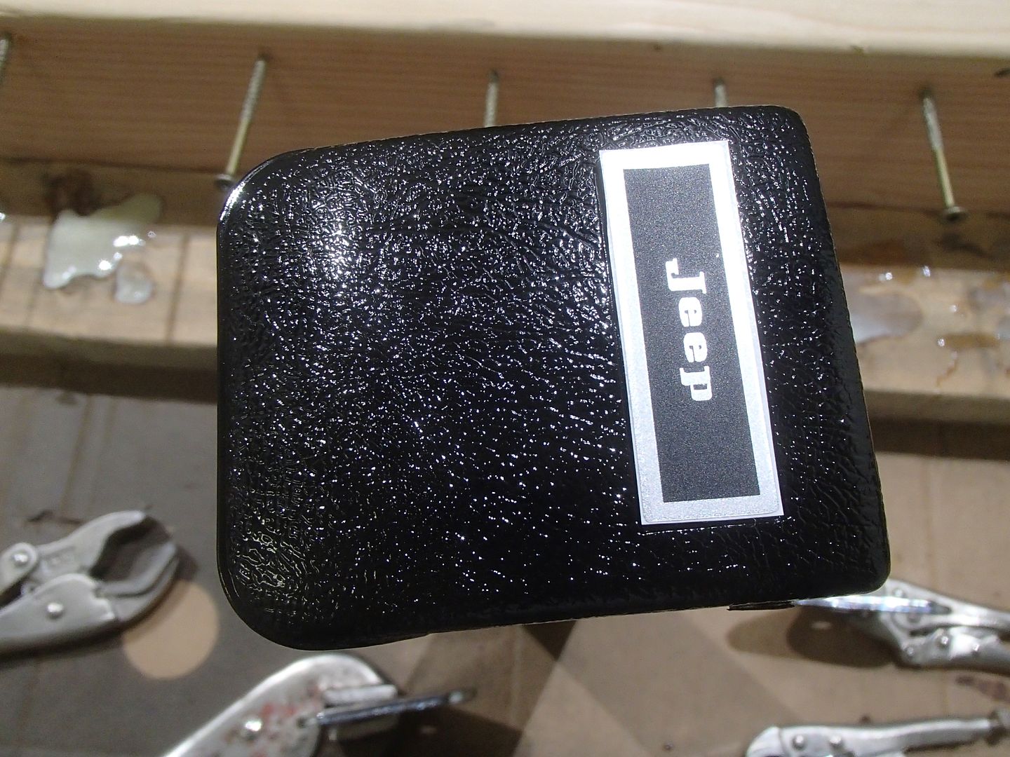

I guess I could not wait to see it. The backing is still on the decal. Looks almost new.

Wow, that looks absolutely incredible...of course so does everything else you have done to and for Sadie. Absolutely incredible!
btw...would you be willing to sell new belts/buckles? My 1970 could use something that pretty.

I think I could probably rebuild your existing belts. I do have a few but didn't want to part with to many. Some are no good. I still need to find good ones in my stash for my X model. I will send you a PM with some thoughts.

I agree completely. That was the first thing on my mind. So I won't be doing that for that very reason and my seemingly big issue of not having enough time. At least till Sadie is done. For the other projects that is.
I did get him set up with a spare (untouched) belt and some decals so he could rebuild his own. That is the best thing.
The companies that do belts are crazy expensive. Unreasonably so... But I get it and honestly, thanks for the very sound advice.
Dave that is a great story about your parents. That name is printed on the belts here. I wonder if they handled them back then?
I got up at 3:30 am to plow snow yet again. We got 25 inches in two days. We already had 18 or 20 on the ground. It is up to my waist. I just got done digging out our windows. The sluff off the roof went 6 plus feet high and blocked our view out. Crazy ... We are no longer shy of snow this year.
I don't get much done in the shop when this happens. I am pretty beat and need a nap. I am hoping tomorrow I can get some shop time in.
And last Friday I flew to Seattle to hang out with Bill and family. I hated to leave. I drove back Sunday in a blizzard after picking up his nephews 2001 cummins 24 valve dodge 3500. Finally a real tow rig.
I now have a tow rig to haul sadie home to that madhouse called Seattle.
