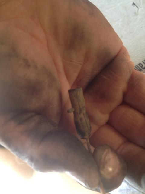

Ok, thanks for the help on that. I think I got it. I didn't see anything coming out of the tank on the front side except the larger fuel line and the smaller "vent line?" I think is what that is. I have another question however, never ending with jeeps I suppose. What is this wire for that was hanging down next to the fuel lines. I pushed it onto a small male stub on the round bung cap on the front side of the fuel tank where the lines come out. It seems to fit fine, I thought it was for the fuel gauge or something, but the fuel gauge is still pegged full. (another project in the near future) Couldn't find anything in the manual. Where do I get a TSM? I bought a Haynes manual, that helps a little.

That wire and a ground should go to the sending unit.
I buy my Tech Manuals off of e-bay. I get them on disk for around $30. You can find paper versions from $50 up.
